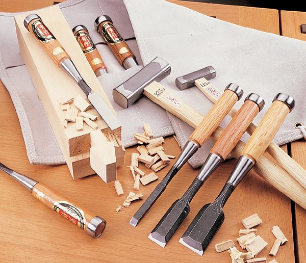

Lots of the Japanese chisels have laminated tips that have a harder carbon steel on top of the standard tool steel. I like that but it can tend to be brittle and chip if it takes a good blow.

Lots of the Japanese chisels have laminated tips that have a harder carbon steel on top of the standard tool steel. I like that but it can tend to be brittle and chip if it takes a good blow. [/QUOTE]
Paul, sorry I did not see your post as I was posting.
What is the thinking behind the laminated tips - cost savings? Any advantages to this configuration?
Thanks![/QUOTE]
It's supposed to make the tips harder. Which is usually good but there isn't much give to it anymore so it will want to break if it takes a good blow.

the construction of the japanese chisels is based on the premise that the very hard laminated cutting portion of the chisel will hold an edge longer etc., whilst the soft iron body will be the shock absorber so to speak.

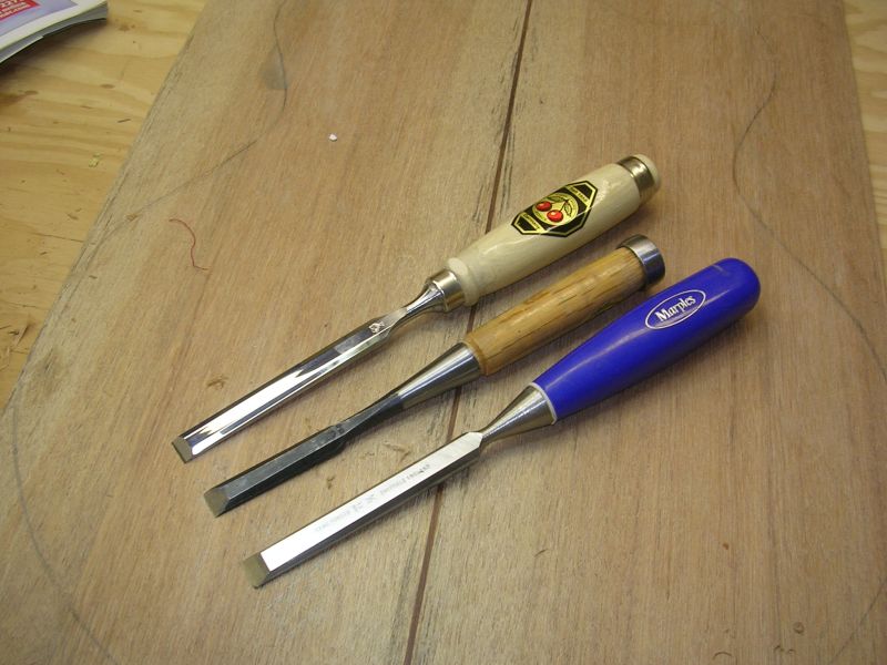

One other thing to consider, if you are looking at Japanese chisels is that there is a marked size difference in similar chisels. The photo below is of three 1/2" chisels. The TC is 12mm the Jap is 12mm and the Marples is 13mm. They are shown on a back outlined for an OLF SJ.
I have average sized hands so both are fairly comfortable. If you have unusually large or small hands it could make a difference.

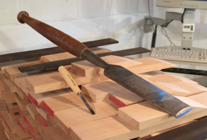

that's a nice slick! thinking of going into the timber frame construction business?
